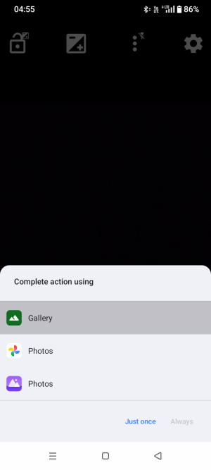

hi, i have this problem
when prompt to select default app appers, option "always" is always grayed out
it affects all apps
i have to chose manually every time
how to enable it?
im using realme note 50 with android 15
it affects all apps
every time "complete action using" popup apeers it does not have working "always" button
this popup shows when you switch apps via link, for example when in camera app i want to open recent photo in gallery, or when i want to open pdf in email attachment, or any file in file explorer...
when i have on the phone more than one app that can open a file, it asks me to choose and i dont have option to save my choice
nope.
newly installed apps behave same way
i also tried reseting google services, trying apps from outside google store, granting all permissions i can think of, changing quick link settings...
only thing to do is reseting entire phone, i do not want to do that

wow. thank you for your thorough responce. was not expecting that.
i was hoping to just find some unchecked box in some deep system settings...
does it also happen with browsers or any other type apps?
yes all of them
How long has it been that you've noticed this?
i noticed it when i changed music player, thought nothing of it, and simply disabled or uninstalled other players to leave only one choice to have no prompt
later all apps that had saved choices one by one started "forgetting" and asking to choose again with gray button
i just tested couple of links and noticed that google email app still remebers how to open doc files, reseted it and problem appered
i think it started happening after one of big syatem updates...
i wiped partition cache
not helped
when i try to boot into safe mode it will not fully start it kept saying that quickstep app is not responding and not showing the pulpit,
only phone is starting progress bar
i reseted and cleard qickstep app data
also did not helped
i tried running the phone with diferent launcher
but safe mode still trying to open quickstep and it still will not run
what now?
