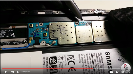

this guy got very lucky. He opened his phone to show how it broke. And actually got it to work again. Check it out.
https://www.youtube.com/watch?v=X4Sz0vwG7UI
It looks like some people have had luck putting the pen in backwards again and then using the straw trick to remove it. That didn't work for me but I did manage to get the pen stuck again. This time it was on the retention mechanism that is further up the silo. I eventually got it out without any damage but be careful if you try it. You could break the retention mechanism.
