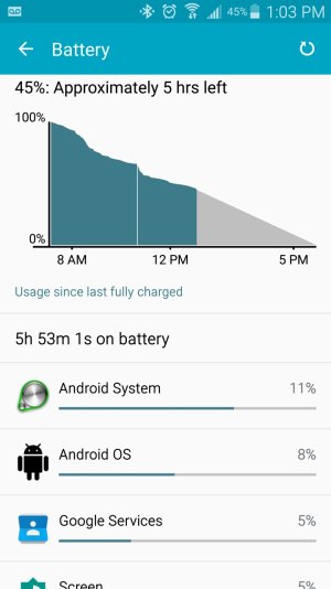

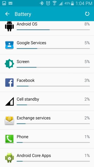

I have the T-Mobile Note 4 and it's running on 5.0.1. These results were using the battery that originally came with the Note 4, not the secondary battery I have. Typically I'll get about 1 Day and 10 hours, I always turn off my phone overnight, so you would have to add those typical 6 hours, and I usually get over 4 hours of on screen time. Since it was the weekend, I used the phone a bit more and drained it all the way out to the next day. Screen brightness is usually at 60%, but I'll drop it to 20% when I'm typing, and increase it all the way if I'm going to see a youtube video. Some gaming here and there. Mainly was on 4G LTE, but I used the wifi for a few hours. No GPS.
I would suggest getting a new battery and seeing how it goes, before committing to $800 to a new phone. This may be a battery issue. Unless you are set on getting the Note 5, otherwise it's cheaper to try out a different battery first.
