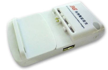

It sounds like the charger port you can get a lil light and look at the lil stick that comes out it should have six lil copper strips on it and also look for any kinda damage if it looks good it could be somthing with the firmware or the port its self. sence your kinda needing it done asap for your trip you can get somthing like this at radio shack 296029869_045.jpg you can also try asking my buddy ADDICT.ANK over at XDA at this help thread [HELP THREAD] Ask ANY Question. Noob Friendly. - Page 470 - xda-developers just head over there and post a reply and quote him in your post telling him your problem he most likly will help you figure it out just be spicific on the phone model and the issue if you quote him he will respond pretty quick oya let him know if it is rooted or not and this is how you quote
