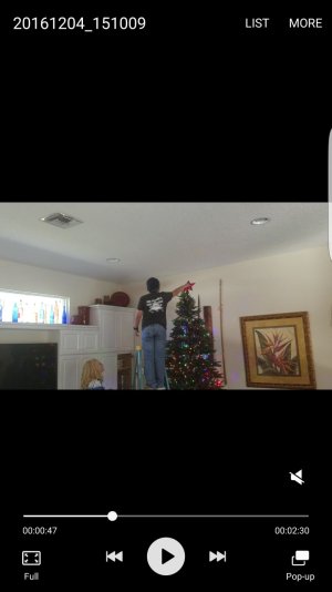

You need to actually play a video, then pause it... then click on the three dots, select settings, and your options should appear. This is how it is on my Note 4 and Note 10.1 tablet.

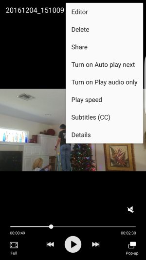

I've included a screenshot with a video loaded and paused and also the options available when selecting more.Screenshot_20161204-191341[0].jpg

It's weird that you don't have settings in the menu. According to all I've read so far, it should be there on the S7 Edge, and capturing photos should work the same as on my devices.

Samsung removed that option on the S7 video player. Well not exactly anyway. Rather, there is no Video Player app on the S7 anymore, rather a new gallery app that can play videos. Hence some decrease in functionality. Besides, that option was basically a glorified screen shot button anyway. So pause the video on the part you want to get a picture of, tap the center of the screen to remove the onscreen buttons and take a screenshot. If you want to skip the cropping part, turn the phone to landscape before taking a screenshot.

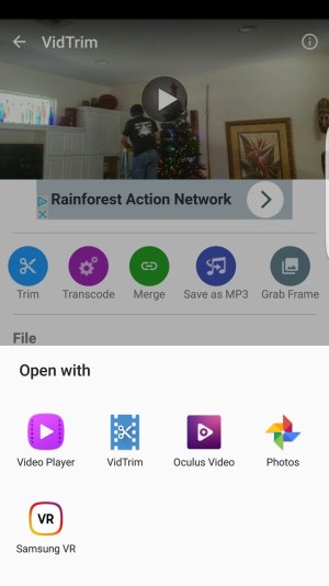

I did a little experimenting to find out what the default player was and if I go to the "set as default" option in app. manager and open Samsung's "Video" app, then clear it as the default, the next time I open a video I'm presented with the option to selected my default player again
The VidTrim option I just installed. It's advertised to edit for Instagram and other social network apps that I'm proud to say I've never used, but the grab frame option does just what I wanted and it took me all of 10 seconds to figure out. Video Player is the Samsung app we've been trying to get to extract frames. Its odd that it called just Video in my app drawer and in Galaxy Apps but Video Player here and in app manager but its the same app. Oculus and Samsung VR are VR headset related so even tho they came installed there not the default player. As you can see the google app's are not even listed and if you open google's movies and tv app you can only open in app content no option to open your own videos. I not sure what Google product you may have seen that's is suppose to be a replacment for a video player. I even checked the play store and couldn't find anything made by google to play videos. That just leaves Photo's so I selected it and the best I can remember it does look the player that was used until I installed Samsung's Video app.
So finial though's are that Samsung must have removed that option from there player, I'm happy with the VidTrim app and it was just the second that I tried so I sure there are plenty more on the app store. So even tho I wouldn't say we solved the Samsung Video issue I think we did do everything possible to confirm that the option is not longer there. I do appreciate all your help and if you come up with anything else I'll still try it just confirm what I think we already know. Thank you again.

Yes, this is what should happen when you clear the default. It's curious there's only one Video player (not counting Vidtrim and Oculus). Did you happen to disable Google Play Movies again before you did this?
I couldn't remember what app I saw in the Note 5 forum... it was around Aug last year so my memory didn't help any. I also tried Vidtrim just a few minutes ago and it's capable of doing the exact same thing as the old Samsung player as far as grabbing frame by frame. I think it's an easy app to use for what you need, so that should work for you. It's too bad you couldn't stay native and had to install a 3rd party, but that's how it goes sometimes.
