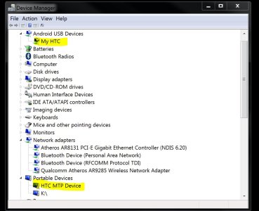

I can get into bootloader / fastboot menu I can get into twrp, when I connect usb it says "fastboot usb in red" in the fastboot boot loader menu so that should be connected but its not. Only time it connects is in twrp, my computer will detect "htc mtp device" it shows up fine in device manager, but after about 10 secs the device is no longer be detected and yellow ! will show over "htc mtp device" in device manager. What is weird even more is I can run certain command with adb " adb devices" tells me its connected but it wont sideload or fastboot , it just says "waiting for device". I can restart the usb by "adb usb", it will temporary install and run but 10sec or so later is disconnects and yellow! will show over "htc mtp device" in the device manager. Does anyone have an idea how to fix this? Is my phone a hard brick now?

Hello. I'm assuming you have the drivers installed? Also, what commands can you run?
Wizzrah | AT&T HTC One XL | Tapatalk
Yes I do have drivers. If im in twrp I can run commands from windows with adb, adb device adb usb thats about it. The usb connection only last for about 20 to 30 seconds than I have to unplug and plug back in, its not the cable I tested 3 diff ones and I tested the usb ports.
