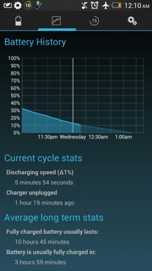

I use battery doctor to ensure I get a full 100% charge, even at around 92% the battery shows full, not sure why. I keep power saver on, have no launchers installed, brightness around 40-50%, let it go on standby after 30 seconds, and always ensure if I won't be using my phone for a while to turn wifi/4g and all apps running off. I honestly have like 7% battery drain after an 8 hour or so sleep.

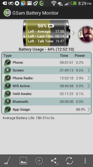

Gps off, auto update on every 15 min. Bluetooth off. Juice defender disabling mobile data while connected to WiFi, etc. Auto brightness.
Sent from my HTC One
