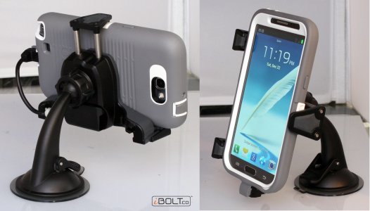

Hello all, we've sold a large amount of the S3 iBOLT Dock and less then 1% have reported back any problems. However, a lot of people (tons!) have asked for a design that can work with the Otterbox Defender or Ballistic style case, that's why we redesigned it so it's open on the sides instead of having a phone specific shape. With this "Generation II" development we also made the insertion point for the microUSB (still triggers car-mode and aux-out) on the right side so the video is not showing upside down when plugged in. With the Note II becoming popular we also wanted to make sure that the opening would accommodate this phone too, even when using an Otterbox on it, see attached "unedited" pics we took on Friday. The Note II compatibility requirement is why we are doing a dual-spring loaded latch with pretty strong retention force instead of the "fold down" type latch.

The new "xProDock" solves the issue with access to the power button and the upside down video. This as you can choose between left and right side for placement of the microUSB. The design is also very "open" so there's nothing blocking any button. Another benefit is of course that any case will fit, even Otterbox Defender and any Samsung handset from S II, SIII to Note II will work fine in this doc.
