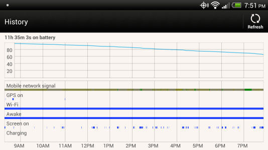

This was today at work now. Different location but significantly less action. I mmaybe answered 20 texts today, checked my mail. Thats IT! Should my results be better?
After 11 hours you were down to 60%? That's awesome!

Yes but keep in mind, it was as if i took it off the charger and barely touched it from 8-6. occasional text message replies. If you look at my posts from yesterday, my "normal usage" results were pretty different. Wondering if all the awake time on my last graph post is an issue?
