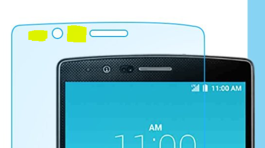

I haven't used a glass screen protector, and I've got on one the way... and my phone will be available on June 19. Here's the protector I ordered: http://www.amazon.ca/gp/product/B00...hawk-future-ca-20&ascsubtag=UUacUvbUpU4494788 If you look at the attached photo, I've highlighted in yellow the glass where it looks like it will block the sensors. So does that mean that this protector will cause that issue? Even if it doesn't cause that issue (screen going black when placing a call), I wonder what it will do to things like auto-brightness or perhaps the functioning of the camera?
That's too bad, not being able to use a screen protector.
Not sure if I would put with that. I have now installed 2 different protectors (a preference thing) and have not had any performance issues.
The current glass protector I have is a full screen protector (an oval for the speaker, not a notch exposing the top of the protector) and it covers everything but the top speaker.....no issue.
Maybe it's that particular protector??? A reflective issue or something?
I have a Verizon tempered glass screen protector, and it works the same both with and without the protector. But of course a poor screen protector can certainly cause problems
I have never had an issue with glass protectors before the one for the G4. I thought the glass was basically the same but apparently it was not. This one was different than the others because the glass covered the sensors and camera. The others had cut outs for them. Also this one was inexpensive. I
will be trying a better one that doesn't Cover the sensors because I really like glass protectors and it's worth the trouble of sending it back until I find one that works without any negative effects.
