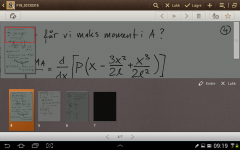

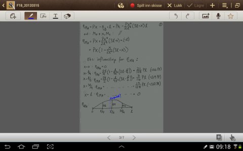

I have a problem when importing pds files into S-note, my note 10.1 wifi import dark dimmed pdf, sometimes even totally black.... i cant figure out how to solve this problem. Any help are very welcome!!
Like many others, my tab is useless without this working properly.
What i alrdy have tried:
- Total reboot of the system
- Downloading firmware from other countries (updates for there wifi version isnt released in Norway yet): SamMobile | Everything for your Samsung Mobile

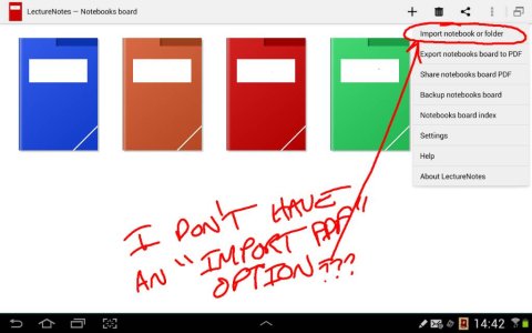

Having the same problem as OP . Have Lecture Notes but can't for the life of me work out how to import PDF'S to lecture notes. VERY FRUSTRATED RIGHT NOW!!!

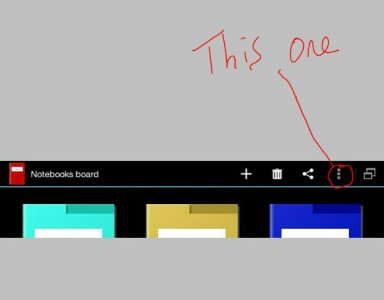

On lecturenotes main page, hit top right 3 dots for settings / menus then inport pdf as new workbook. Took me a long time to find out.
Or if you want to add a pdf to existing note book, open said book, then as above .
