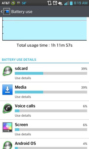

As of the past few days, I have noticed an increase in time needed to charge fully, from dead (from roughly 2 hours to over 4 hours) and also a decrease in the ability to maintain the charge.
From unplugging, I was down to 78% after one hour of very minimal use (One phone call and a quick check of the home screen).
I took a screencap of my battery stats, if this can offer any insight.
The massive drain from SD memory is worrying.
Thanks.

Have you tried other battery apps that give a lil' more detail on what's sucking your battery?
Check your SD Card, it may be damaged. If the card unmounts/remounts itself randomly, the system 'scans' the card for errors every time it remounts, and the more files you have, the more time it spends scanning... This, of course, drains your battery like crazy.
