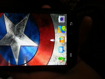

You can tell it's on when you look at the lock screen and there's a microphone at the bottom. Then it works (for me); it unlocks the phone and launches S-Voice. The app doesn't need to stay open. Still not as useful, since you have to turn the screen on first.

Holy Smoly, forget the dang locking/unlocking - what a beautiful lock screen!!!! That silver is stunning.
