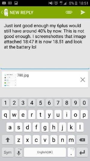

Just isnt good enough my 6plus would still have around 40% by now. This is not good enough. I screenshottes that image attached 18:47 it is now 18.51 and look at the battery lol

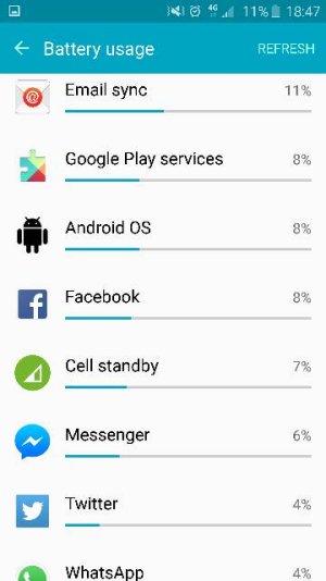

You seem to have the Google Play Service Lollipop Bug, look for my Thread on the regular S6 forum to read about it and to learn what you can do to at least try to stop the service from keep draining your battery.
Also, your Email Sync doesn't look normal, check your Email Account and Sync settings, something is getting stuck there.
