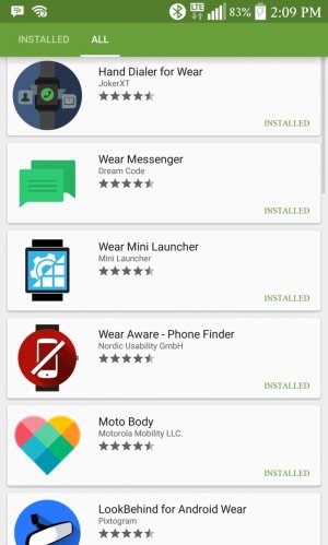

I just use one of the stock watch faces,nothing too fancy there. I don't use Google Play so I don't think that's it. QuickMemo+_2015-09-16-14-09-13.jpg
Besides these I have Calculator for Android Wear installed and I don't think any of them are battery hogs. I'll give it a reset tonight and see how it goes tomorrow.
