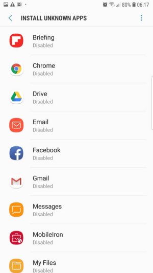

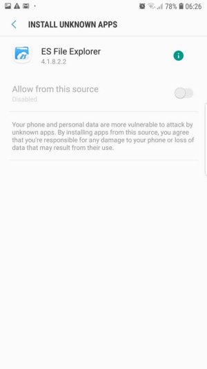

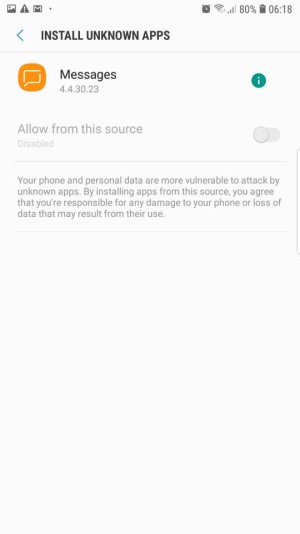

Hi guys
I'm having an issue with my Samsung Galaxy Note fan edition. I tried downloading an APK file and when I click to install it, a screen pops saying I need to uncheck the "allow install unknown apps". The problem is its disabled and there is no way I can move it to enable. I have attached the pictures. Its really annoying I have tried everything from factory reset to disabling any light app to restarting the phone nothing seems to work! I even tried downloading a new file explorer app as someone mentioned to try that and still no result.
I came across many users who had this issue and below are some links that are related to my issue but I still cant figure it out. What is strange is if you look at the picture I have attached, there is a whole bunch of other sources which are all disabled such as Chrome, Drive, Facebook, Gmail etc and there is no way I can enable them to download from these sources.
In the link below, the user said to disable blue light filter as it was interfering with the touch response...I tried this and it doesnt work. But I do believe this could be the issue because I can toggle and click everything else except for the "Enable" push button. I dont remember downloading any screen or light filter hence Im not sure what could be the issue.
https://forums.androidcentral.com/s...-help-cannot-install-3rd-party-apps-apks.html
Would really appreciate it if someone could help because at the moment there is no chance of me downloading any app that isnt available on play store
Thank you

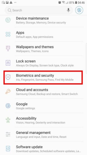

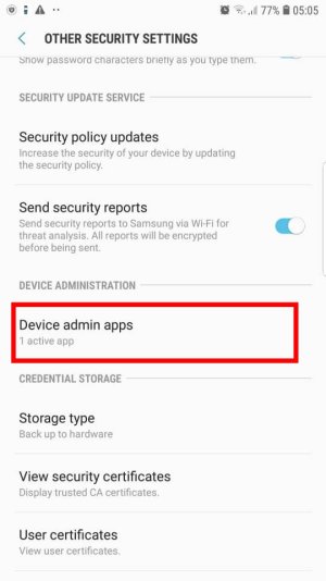

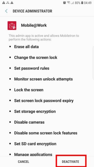

Thanks for the reply. It worked! It was a security settings issue. Steps below is what I did to solve this issue and I have also attached the screenshots
1. Go to settings
2. Click "biometrics and security"
3. Click "other security settings"
4. Under Device Admin, click "device Admin apps"
5. Deactivate all device Administrator apps. Now you will be able to enable 3rd party apps installation. Once the installation is completed, activate admin apps again

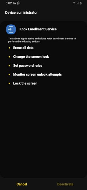

Mine are not like you i have 4 apps 1:find my device 2:Firmware recovery 3:KC Client and 4:Knox Enrollment Service.Only find my device that i can activate/deactivate but the rest i can't

Yes my phone problem have the same as Leornardo0237's problem. Theres 4 apps in there and even the "DEACTIVATE" button also are greyed too so it couldnt to do so.
Leornardo 0237, is your phone problem solve? If do pls share in here. Im using Samsung A30s. Pls help...
Thanks in advance

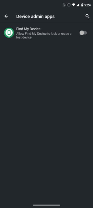

I tried that there are no active admin apps and I still can't enable install from unknown sources
Can anyone help?

I have a motorola g 5g 2022 version 12 and i disabled my admin apps (find my phone) and the options to install unknown apps are still greyed out. i tried a few things i saw on the internet and none of them worked. i called the phone company and they said that its not allowed and wouldnt tell me how to fix it. is there anyone who knows how i can install apks without this or how to fix this?
Welcome to Android Central! Find My Phone wouldn't have any impact on your ability to install apps from unknown sources.
Is the phone managed by your workplace? Or did you add a work account to the phone?
What phone company did you contact -- your mobile service provider, or Moto, or someone else? They typically wouldn't have any insight into this kind of thing, so it's odd that they would say it's "not allowed."
