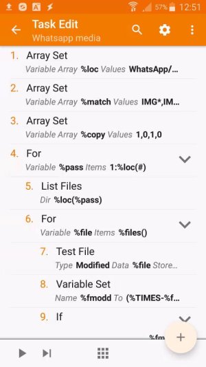

I've spent half a day learning Tasker, and now have a fully working solution. BTW, not shown in Gallery, Whatsapp also stores a copy of every file you have sent, you can find these using file manager. This is particularly pernicious, because you will be chewing up storage without realising it, and might also be retaining a copy of a sensitive file you thought you had deleted. If you send the same video five times, Whatsapp will save five copies of it!
Moving the file out of the Whatsapp device directory will make the image in Whatsapp blurred, and you can't click on it to see the full size file. Because of this, my Tasker script only looks at files that are older than 10 days (you can choose whatever limit you want). It moves (actually copies and then deletes) received images and videos, and just deletes sent files.
I'll post up the full Tasker script, with notes and screen shots in the next day or so. I just wanted to let people know that there IS a fully working Tasker script now available.
Ok, as promised, here is the Tasker code.

  3. Save this file http://www.stevewaring.me.uk/tsDownloads/TaskerWACleanupTask.txt as a .txt file on your phone.
  4. Using My Flies or a similar file manager, create a folder on your SD card to hold received images and videos. I called mine WA media. I'd advise avoid calling it a name that starts with Whatsapp, as it is very confusing in Gallery if you do.
  5. Import the file as a Task. To import the file, long press on the TASKS menu option in Tasker and you will get an import option. I've not imported a file, so I am not sure of the dialogue, but you should call the task Whatsapp media
  6. Tap on the task to open it in the editor. It should look like this:
  7. In the first action an array is set to these four locations:
    WhatsApp/Media/WhatsApp Images,WhatsApp/Media/WhatsApp Images/Sent,WhatsApp/Media/WhatsApp Video,WhatsApp/Media/WhatsApp Video/Sent
    , if they are not where Whatapp stores pictures and videos on your phone, you need to tap on the action and edit the text.
  8. Tap on action 10. Edit the To value to the folder you created in step 3. Tip, use the magnifying glass icon to browse for the folder.

  9. If you want to change the number of days before files are moved, tap action 9 and change the number from 10. BTW Ten days and one second counts as greater that ten days in regards to if a file is actioned.
That's it, as far as the task is concerned, you can run from inside Tasker by tapping the play button at the bottom
