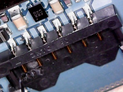

You already replaced battery and the same thing happens, I meant short battery life or quick discharge, you should look for this battery connector:
Assume you know how to solder, using a screw driver or something solid and look closely under magnified glass, gently push this connector or lift it, if it's moving then you need to re solder this battery connector. Another test, slap hard on the back cover at the location of the battery connector with your hand if gently tap doesn't work, if your tablet shut down immediately, then the battery connector's solders already cracked or loose.
Apply flux, reheat and add more solder to secure these six pins to mainboard. It will fix the quick discharge problem.
After this, test your battery again by maximum loads or setting and monitor how much it drops after one hour, as I said above, good battery should not drop more than 20%.
