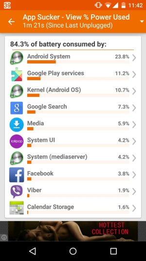

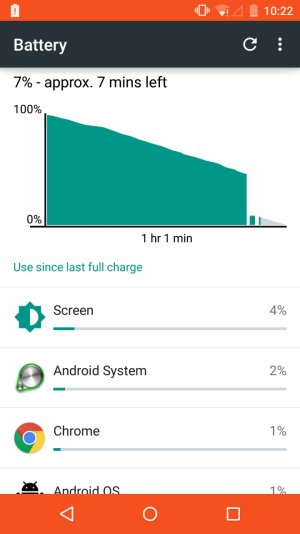

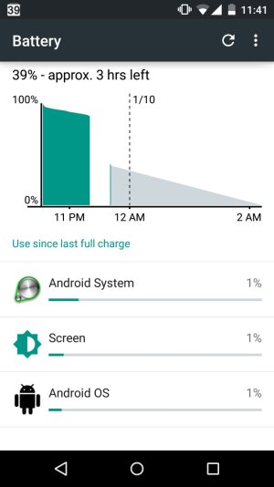

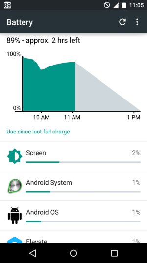

Since Android L my battery life has gone down tremendously but it has worsen with 5.0.1. I have basically almost everything turned off, including google now, location, and wifi when i'm not using it but It hardly last more than an hour of screen time. To make matters worse, recently my OS would get hot quickly and turn off abruptly but when I turn it back on the battery which was more than 50% would be below 10%. Sometimes If I dont use it, the battery would increase without charging. I never had this problem with Android L preview built and it was actually batter than Kitkat. Could this be hardware related or a software bug? I installed 5.0.1 through manual flashing.
