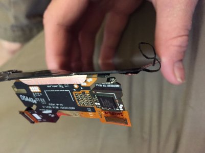

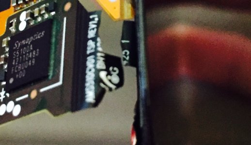

See picture of lcd assembly that i removed in order to replace cracked glass. i think i went in too deep with tool to seperate lcd from motherboard. see picture of rip in flex cable. i plugged lcd back into m b and screen worked, but no touch working. is it because of cracks in glass or damage i did?IMG_9137.jpgFullSizeRender (4).jpg

Damaged yes, but hinder function? Would that make touch not work because that's the only thing not working. I don't think any wires were running through there, just plastics
Put it back together with the new screen . You'll find out pretty quick . Looks like you tore a flex .
See picture of lcd assembly that i removed in order to replace cracked glass. i think i went in too deep with tool to seperate lcd from motherboard. see picture of rip in flex cable. i plugged lcd back into m b and screen worked, but no touch working. is it because of cracks in glass or damage i did?View attachment 140332View attachment 140333
It looks like you ripped through the touchscreen controller on the bottom. That little black chip is what identifies when you touch the screen. Sadly, it looks like you'll need a replacement
