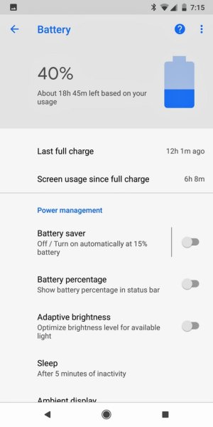

If you could post a screenshot I'm sure some of the battery gurus around here would comment. Here's one of mine where I had charged it up in the morning then used the phone most of the day. I think 6 hours of screen-on time with 40% of battery remaining is outstanding.

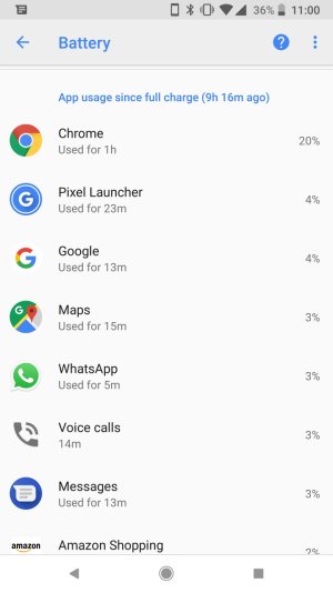

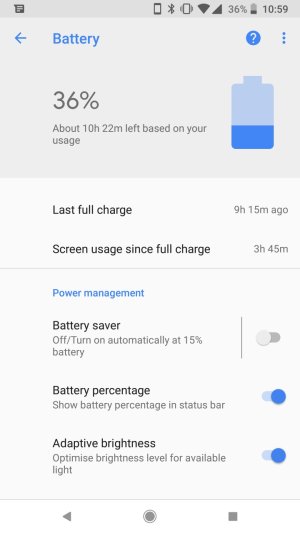

here are 2 screen shots.
I am pretty much in the same areas and doing the same things as I did when I had my OnePlus 5. Reception is the same.
I know the Higher resolution and higher DPI on the Pixel XL may use more battery life, but i didnt think it was this much.
Thanks
I just realized that you have the original Pixel XL and not the 2 XL. Looks like you would end up with a bit over 5 hours screen time before needing recharging. Maybe 5 1/2 hours if you pushed the battery under 10% (I don't like doing that.) That's not too shabby. Of course if you are used to getting more battery life, it's tough to downgrade to lesser amounts.
My son has the original Pixel and he gets over 6 hours screen time but he also has his screen set so dim I can hardly see it. He says my 20% setting on my screen is way too bright (ha ha).
Looking at your app usage nothing really jumps out. If you used Maps for navigation and had your location on high accuracy that would take a bit more battery than other apps. But only 15 minutes of usage. If you don't use navigation that often you could reduce your location accuracy to "battery saver". Settings > Location and Security > Location > Mode > Battery Saver

Looks like Chrome is using a lot of your battery. I thought I read somewhere that Chrome is a bit power hungry. I use Chrome as well. Perhaps downloading or using another browser app may help as well.
Could be faulty. But I'd first check to see what tasks are running like what Morty said Google Chrome does eat up alot of your power,
