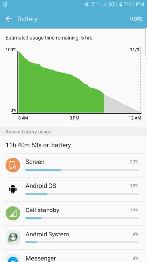

Charge up to 100%, then let it drain to 20-30% with normal usage, without charging in between. Then show us:
1. The main Settings>Battery screen.
2. The fullscreen battery graph screen (which shows Awake time and Cell Signal Strength).
3. The Screen category (to see total Screen On time).
4. The Cell Standby category, if present (to see Time Without Signal).

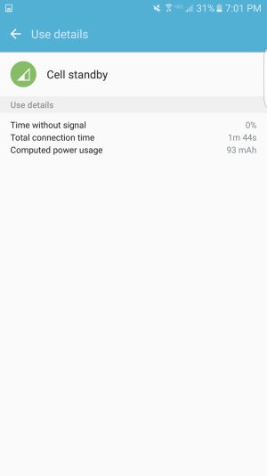

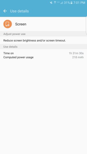

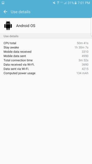

Cell standby is proportionately high, and the current cell signal at the time of the screenshots was fairly poor. If it's like that for much of the battery charge, that could contribute to battery drain. Since Samsung phones generally don't include a cell signal strength indicator in the battery stats (from what I've seen on the forums), you could install GSam Battery Monitor to get that information.

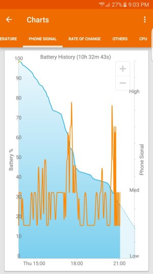

There's a battery graph that also shows cell signal strength -- show us that (after charging up to 100% and then using it normally down to 20-30%).
Oh okay, I forgot I did a factory reset and never installed it. I'll have to charge it back up. However, over a 4 hour period, it's only consumed 31 mAh and had a total connection time of 19 seconds I've had 1-3 bars all morning thus far
As suspected, cell signal strength, is mostly middling to poor, so that's probably a big reason why you're seeing the battery life that you do. If you're able to use the phone in an area with good signal for a whole charge cycle, that would be an interesting comparison. Or you could try using the phone on Airplane Mode for a whole cycle, but I'm not sure how feasible that is.
If battery life was dramatically better, then it would strongly suggest a cell signal issue. (Battery life is better anyway on Airplane Mode, but the improvement wouldn't be as great if you had good cell signal to begin with.)

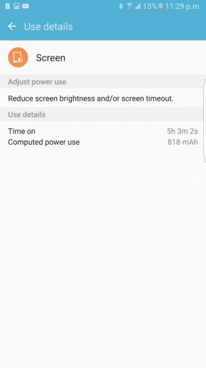

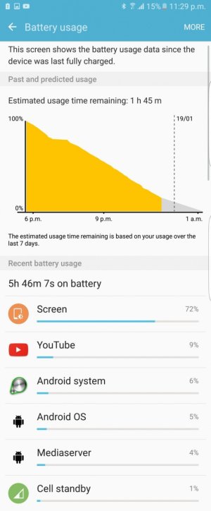

Please check if this screen on time is normal or not? The screen was on continuously from 100% to 15% on 50% brightness and on default settings with power saver mode OFF. Please comment on this. Thanks
5-6 hours is usually the sweet spot for stock batteries. Your battery is performing very well.
