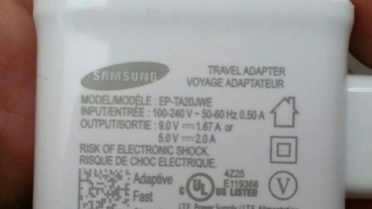

It is a 9v 1.67 amp charger... Just looked at mine. It is a physics thing.. Can't charge faster than the current is flowing. Sorry about you icrap not having the biggest, fastest best charger.
Oh and I use 2 amp chargers all the time on my Android devices and it takes advantage of it quite nicely.

Most chargers are fairly stupid. You can typically get a no brand 5 volt charger. They have 5 volt output, and the phone adjusts the power going to the battery. But they are reaching the limits of what you can get at 5 volts. So Samsung appears to have put some smarts in the charger. The Samsung charger can set the output voltage up to around 9 volts. That gives the phone more to work with to get what sounds like around 3 amps into the battery (50% in 30 minutes, about a 1C rate). Then the CHARGER voltage falls back to the normal 5 volts.
IMHO, if you must have the 9 volt and fast charger rate, only ever use the original Samsung charger. I will be using my many cheap 5 volt chargers for a slower charge myself.
I was wrong. I just picked mine up and it does go to 9v to fast charge.
Sorry about the misinformation.
