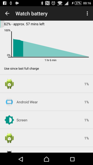

Hello guys, i've got my moto360 today. the battery is draining too fast. the battery was 100% at 10:00PM and it's 11:10PM in here. the battery is now in 31% :( how do i solve this issue. software version is 5.0.2. Ambient screen is turned off.

Thank you :) just started the update and it still downloading. i've also tried by reset, re installing the wear app on phone. but the problem is same :/

This is the 1gen version. I didn't try it while wearing yet. I've turned off all of the display functions. Ambient, tilt to wake up, etc. Recently updated to v5.1.1
