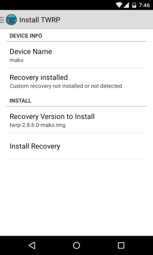

I am getting an error after entering recovery mode. No command. Now what to do?
You have boot into TWRP and flash it, restart your phone and hold VOL DN and PWR button from off... Then start recovery, you flash it from there... If you are unfamiliar with doing this, you might want to check out a few YouTube videos on using TWRP
