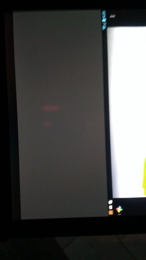

I have the Nexus 7 LTE and recently saw these 2 red blotches show up on the side of the screen by the camera. Any ideas on what this is? I did call google support and they suggest full reset and if that did not work, a replacement would be in order.
Has anyone else experienced this issue? It is only visible when on black screens.

Any way you can take a photo of the screen and post it?
This is a good shot of the Red blotches. Only seems to be visible on the Black/Grey screens. Google is asking me to reset the device and see if that helps. If not, they have offered to send a new one.
Thanks for posting the picture. It kind of looks like the blotchiness that can normally be seen on a lot of phone and tablet LCD screens on a dark background. It's not necessarily a defect--I've seen similar blotchiness on virtually every device I've ever had. But it's hard for me to tell for sure--looking at it firsthand would still be better than looking at a photo, no matter how high quality the photo was. Is it completely unnoticeable on any background besides a black one?
I can only notice it while on a black screen. Does not seem to appear with Apps or other colored backgrounds. Can I change the background color while looking at photos? That would perhaps allow me to play around and see if it shows up with other colors.
Sorry, I'm not aware of a way to change the background color. There's probably some YouTube video that will cycle through a palette of colors, so you can see if those blotches are noticeable with any particular color.

So you called Google support vs Asus?
Yes. technically, they were unhelpful, but they instructed me to do a clean reset and see if it remains. If it does, they are sending me a replacement unit supposedly.
