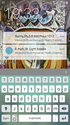

Having an annoying problem where when I'm doing something using the keyboard and put the phone down.
I go to open the phone to the lock screen and the keyboard remains blocking my pattern to open the phone.
The only way I can open my phone is to (double click) open the camera.
I have the same problem on my SG4. I have to either pull the battery or restart(which requires that I switch to the smaller keyboard so I can get to the restart button). I've had the phone for two years. This is a new problem.
When I pull down the notification bar the same problem happens. It also happens when I turn off my phone. I have had the Note 4 for as long as it has been out and this problem started about a week ago or less even! Please help Samsung! More and more people are getting this problem!
This is mine when I've been txtin or writing something and get interupted.
It never happened on my s4 though..

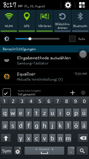

Hello guys,
I got also my keyoard stuck, but everytime I slide down the notification panel. The keyboard is still on top of the notification panel.
Does anyone have the same problem and know how to solve it? It really is irritating :'(
Thank you in advance
