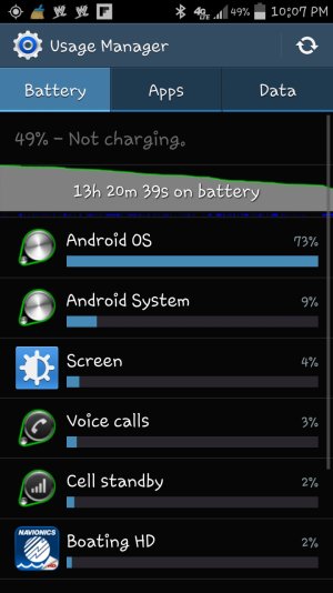

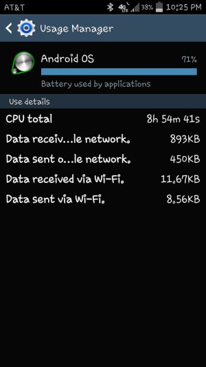

[[/ATTACH]Screenshot_2014-06-29-22-07-06.jpgScreenshot_2014-06-29-22-25-17.jpgI have been holding off on updating to kit kat for some time now. I never jump right in on any updates till the bugs are out. So I figured it was time. We'll I should have stuck with my original thoughts. Today was the first full day and it socks. Battery life is abysmal android os has used 72% in 13 hrs. Wtf this blows if there are thought or suggestions to fix this problem please I am all ears. There is no way I will be able to this phone if this is how it is going to be. Not happy.Also only have 1.5 hrs. of screen time basically didn't use phone hardly at all for the majority of the day.

1) That 72% doesn't mean 72% of the battery charge, it means 72% of the 51% drain shown in the graph. (You have 49% left, so you've used 51%.) That's 36% of the battery charge.
2) The first few days, any update is going to be using wifi or mobile data a lot, syncing things up. Not only the things in Google sync, but OS things as well.
3) After an update, you should at least clear user cache. Clearing Dalvik cache may help (after the first boot, which will seem to take forever). A complete factory reset might also help, but unless you have everything, including your data, backed up in a way that's easy to restore (like a Helium backup including apps), I would save that as a last resort.

correct I do realize that, but like most of us we pretty much know our phones patterns, behavior, and usage for our typical days. I just knew right away that it definitely was not acting the same. I turned off google+ and now that had helped, but during the day I noticed that boat browser was using a huge amount now. It does not seem as if it has been optimized for K K yet. I turned that off and installed dolphin and opera and things seem to be better.as of 9:00 pm I have 23% left with 13hrs. since taken off charger and over 3 hrs. screen time. Much better and I'm sure it will be better yet now that boat browser was disabled later this after noon. Thanks to everyone with there suggestions
