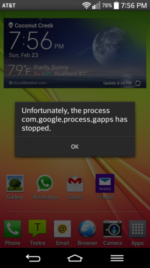

I downloaded and ran the KitKat update and when I rebooted my phone I will get the following message in the screenshot below.
I googled the error message and tried the fix posted in the past... disable/enable download in apps, reset app preferences... nothing fixed it.
So I decided to backup my photos and wipe the phone and no more error message.
But I only installed a few apps... Textra, Yahoo Mail, WhatsApp, SwiftKey Pro & Beta.
I disabled all the bloatware in Apps.
Then I customized my app drawer by grouping apps in a couple of folders.
Then I rebooted and got the message!!
Tried goind backwards like removing folders in app drawer and reset app prefs again and still there.
Ugh, I'm gonna have to rewipe because it bothers me but wanted to report it and if anyone gets this too and find a fix, please pass it along.

Darn it... It's SwiftKey! The moment I installed it and tested ok and rebooted... Error message. Uninstalled it and it's gone. Darn cause I'm not a fan of stock keyboard.

WOW! I just changed the keyboard to Kii Keyboard and rebooted the phone and I did not get that message!
I then switched back to Swiftkey Beta and rebooted the phone and I then got the message!!!
So Swiftkey is the culprit!!!
I have swiftkey installed on my LG G2 with kitkat i changed it back to LG keyborad and the error went away wth. its been working fine for a week or so with kitkat
Ok I uninstalled swift key the paid version which i purchasedand reboot the phone and reinstalled swiftkey and this error comes back
google.process.gapps error
i reboot the phone still same error , I uninstalled swiftkey the error goes away. conclusion Swiftkey and Kitkat 4.4.2 not playing nice. I hope it gets resolved I like my swiftkey

This was driving me crazy today (LG G2), and I went through ALL the recommended fixes, but nothing worked. Then I remembered my Google Keyboard had recently updated, so I uninstalled it and the problem was fixed! Ironically I had originally substituted the Google keyboard for Swiftkey when Swiftkey was causing the same problem, but now it's the Google keyboard causing the problem! I did not reinstall the Google keyboard, but instead installed the Swiftkey keyboard and the issue seems to be corrected! I suppose it's possible that uninstalling and reinstalling the Google keyboard would have fixed the problem, but I prefer Swiftkey anyway. Hopefully this sticks, we shall see tomorrow. The only time I was seeing the error was on bootup, and I don't think it was impacting anything, but it still bugged the hell out of me! Best of luck!
... but now it's the Google keyboard causing the problem!
Turned out it was Google Keyboard causing the same issue for me too. Uninstalling Google Keyboard gets rid of the error at boot. I then tried re-installing Google Keyboard, but the error comes back. Which is unfortunate.
Ok folks, here it comes... the fix to all your problems. This bug is part of Google's transition from the Dalvik runtime to ART runtime. Do the following:

The fourth option down is "Select runtime", it is most likely "Dalvik". Select it and change it to "ART". When you make this change it will tell you that you need to reboot. This made me nervous, but I accepted anyways. Your phone WILL TAKE A WHILE to reboot!!! It needs to upgrade a LOT of apps and components, but it WILL boot, do NOT hard reset it!
