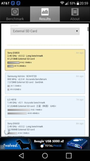

Never used the SD bench Mark. Anyone know what this test revealed?
Trying to upload a pic of my sd bench Mark.

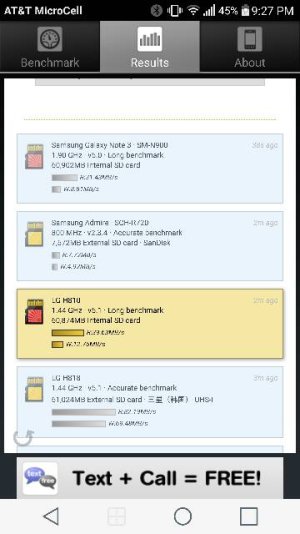

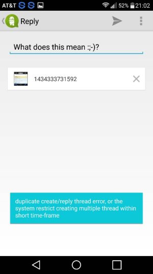

Sorry for the duplicates guys. I kept getting that error, it it was actually posting.
Posted wrong shot. I'll get this right eventually. :-)

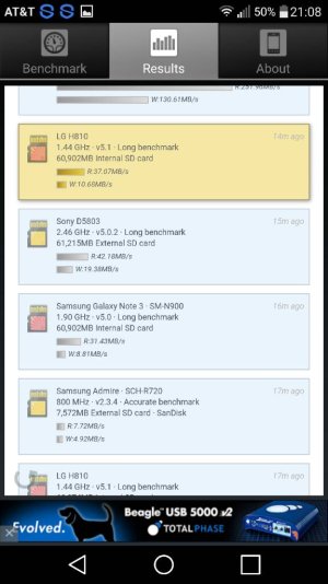

I have no idea what this means to me...
