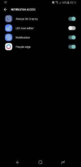

Here is screenshot.. Could this be what's causing the problem?
Phone is not letting me turn that on.
Unfortunately this seems to be related to the Samsung LED cover case, and can only be turned on if you purchase the case. Most likely it has nothing to do with the LED indicator that likely broke.

Hi I joined this website to give you a fix, mine was disabled and could not be enabled, what I did is disabling everything then just enable the led icon editor and then enabled the rest, now it's working fine.
