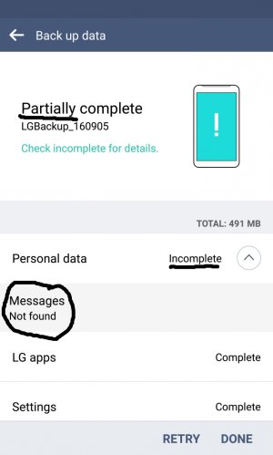

I just updated using Bridge (T-Mobile version of V10), and now LG Backup fails (or "Partially complete" to be specific. It might be a Textra issue since everything backs up but SMS. The error I get is:
LGBackup Partially Complete Check incomplete for details
Then below under personal data - "Messages not found"
If you have completed the system update can you check if LG Backup still works? Textra and non-Textra users would be great!

This is a screenshot. The result is "Partially Complete" and under "Personal Data" - "Messages not found"
So LG Backup can't find the SMS (Textra?) messages.

My theory is that a new "feature" of the last update - LG is checking for the XML format of the messaging, and if not stock LG app it intentionally ignores the data.
The "solution" is to use SMS backup & restore for the backing up SMS /MMS. If there's a better backup option I'd love to know.
The way I got around this was to delete textra and then re install it after backing up :$.
