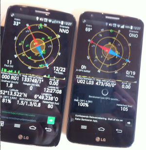

Heya,
Since I got my LG G2 I experience a weak GPS signal and unusual high magnetic field numbers. A GPS fix takes quite long and is less accurate than the G2 of a friend. Funny thing is: I had the same problem with my previous G2 which I got replaced by this one.
Und exact the same circumstances as the other G2, mine just functions very poorly. See the attached screenshot for difference in fixes and magnetic field. Settings are exactly the same and I already tried clearing the AGPS, turning it off and on, rebooting, resetting and having WiFi turned off and on. Update to 4.4 didn't change the situation.
What can I do about it?
