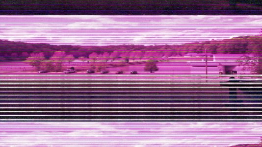

The camera on my LG G3 D850 has been acting badly lately. When I open it, sometimes it will work for a few seconds, then gets these purple lines across the screen, and usually crashes. Sometimes it won't work at all. This only happens with the rear facing camera (front-facing works fine). I have cleared cache/data, tried to reinstall camera app, even did a factory reset, all to no avail. Has anyone seen this before? Is there any way this could be software and not a hardware issue?

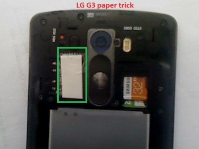

Quite some LG G3 users have this issue. Just read this URL:
Solution: the paper trick
put a piece of paper at the back of your phone, under the cover or case, but you won't have to screw anything open. The paper can have a size of 1x2 cm = 0.4x0.8 inch. The thickness should be about 1 mm so cardboard is better. Put the paper to the left of the camera and beneath the black infrared sensor. Put some tape on it to have it fixed.
That's it. My phone is running for a month now. If I remove the paper, the flickering occurs again. With the paper, it just doesn't.

Like I said, it happens when I use the camera. Not on any other screen. I believe you are talking about a different issue.
But it's worth the try, isn't it? It will just take a minute.

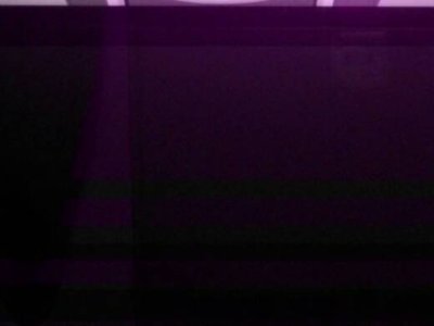

Mine does that too...
