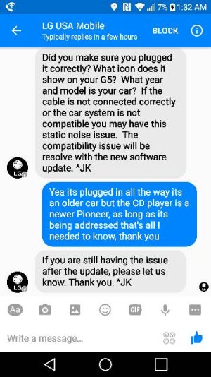

I get that hissing sound from my G5 also. Oddly enough, the auxiliary Jack in my car is the only place where it happens. Using the auxiliary on my home speakers works fine and using it in my mother's 2015 civic works too. I have a very average after market CD player so I thought that was the problem, but all evidence points to the contrary. Three other random phones work fine in my car as well. The only inconsistent one of the bunch is the G5. Headphones are crystal clear as well.
Update: I met up with a friend who has a G5 also. His phone has a hiss in my car too, but both of our phones don't hiss in his car. He has a 2009 Pontiac with a stock radio.
At a loss here.
I've noticed two different types of noise when outputting audio from my G5 through the headphone jack to the aux input in my car. I'm using the same cable and car charger that I had successfully used with my HTC One M7. The first noise is a high pitched whine which changes pitch when I accelerate and is eliminated by disconnecting the charge cable. The other sound is the static which you have described. I have tried a couple of different audio streaming apps and the noise persists. One thing I have noticed is that when there are moments of silence during the stream (i.e. a podcast and there's a pause between the people speaking) and when you actually pause the stream entirely the static is not there. This leads me to believe that it may be induced during the digital audio conversion and hopefully a firmware update could address it.
