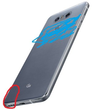

Hi guys, this is where the portion of my phone heats up whenever I play music at max volume(please see photo)
I just normally play music; my entire phone doesn't heat up at all, only the red circle at the photo.

So the red part and the blue part both heat up ? I use system monitor aswell as cpu-z...

Only the red part heats up when playing music. The blue part normally heats up when I'm using certain apps such as Facebook etc, blue part ain't issue to me
