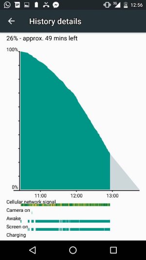

Lg nexus 5 Battery percentage isn't accurate to battery usage in settings
It's difficult to tell very much after only 50min of usage. Could you use the phone normally until you need to recharge - at 20-30% charge remaining as B.Diddy suggests - and then post screenshots of the stats?

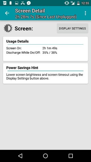

hey sorry for answering too late i've been busy.
Just over 2h screen-on time with 27% charge remaining, while not impressive, is not too bad for a Nexus 5, assuming fairly average brightness levels.

The Nexus 5 has a higher-res screen (1080 x 1920 vs 720 x 1280). Pushing more pixels takes more power, so that's probably one of the main factors.
That's true.
because screen is the first thing that take up more percentage of my battery.
as you see in screenshots.

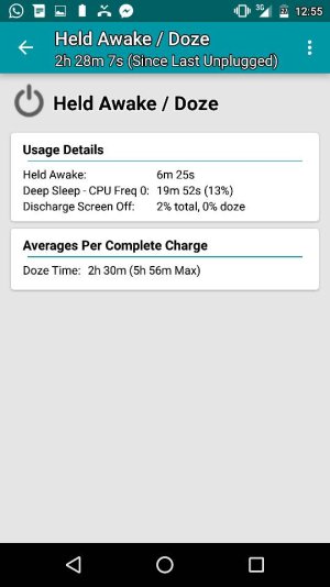

also doze seems to be not working for me.

Doze won't activate unless the phone has been completely motionless for a certain amount of time. So if you're always carrying it around, Doze won't ever come on.

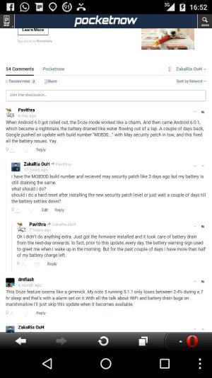

i know some people that had this problem in 6.0 and after they recieved 6.0.1 and MOB30D build number and May security patch level their problem have been solved.
personnally,i have the MOB30D build number and recieved may security patch level and installed it.
but the problem remains the same and nothing has changed for me.

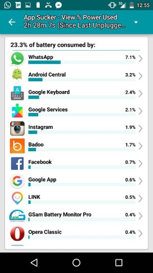

but my phone's battery drains when data is enabled and using something that uses data such as whatsapp or web.
it doesn't drain when data is enabled and reading msgs or editting photos for example.

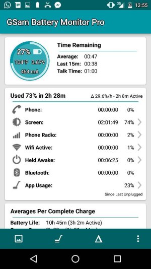

this is weird because my phone radio seems to drain the battery but the GSam app shows screen on the top which used more percentage.
