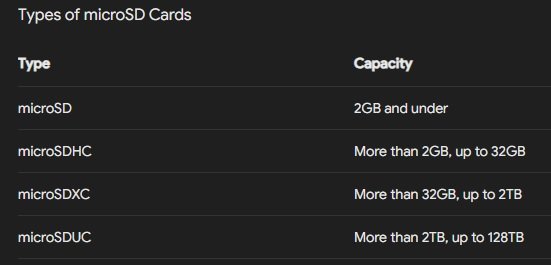

The only other thing that comes to mind, which would be a guess on my part anyway, would be that your SD is the wrong class for this device. SDs are less expensive per unit of memory so I could imagine you getting a newer, either faster or higher capacity SD that the device cannot handle. Have you tried other SDs in this device?
I looked it up and this device is only compatible with SDHC models. I don't know SDs like the back of my hand or anything so I looked this up and found that SDHC appears to only go up to 32 GB and look like most are class I, or class 1, is this what you have?
A second thing is where did you get this SD? Again with the price of SDs these days it's tempting to also try and save a buck, or a Loon, a pound, a franc, a Rupee, whatever you call it, which can lead to knock off, counterfeit, cards, is what B. Diddy would warn about. How confident are you that your card is good?
That's about all I can think of right off. Let us know what you find and we'll try to offer more advice.
