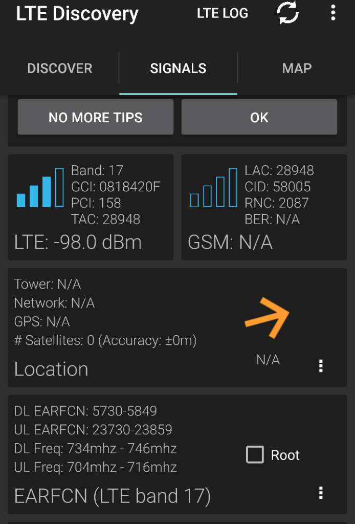

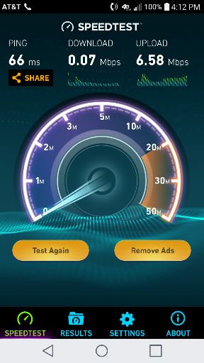

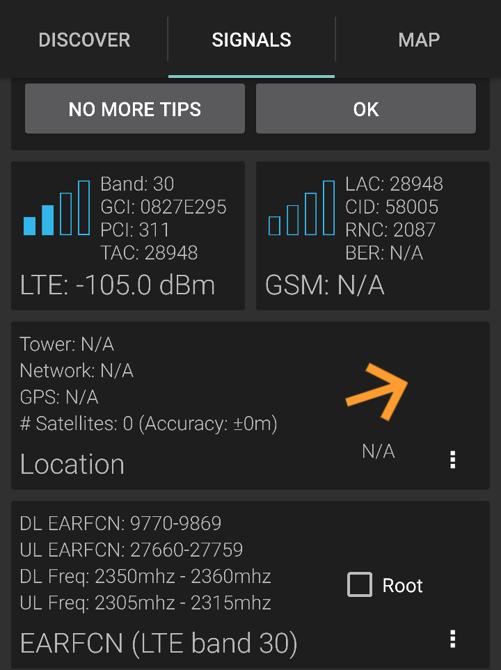

I'm also having problems, it seems to be band 30 issues for me.
when it slows down on band 30.
I went in today and got a new sim card hoping that would fix it but not sure it's going to. At the moment I'm at -103 dBm. I've been averaging between -99 and -105

Band 30 is the problem not the Phone, I have done an unofficial experiment with phones on AT&T that have band 30 in them vs ones that do not have band 30.
1) AT&T branded Samsung Galaxy Note 5, Always kept staying latched on to band 30 and would be sitting around - 119db.
2) Honor 8 unlocked no band 30, would usually hang onto band 2 or 17, usually sitting around - 82db.
3) Moto X Play unlocked, no band 30, would be on band 2, 5 or 17 typical signal - 81.
4) OnePlus 3, band 30, typical signal - 118db.
5) AT&T branded LG V20, less hanging on to band 30 then the others but when it does signal is around - 119.
I wish AT&T would explain why their own phones utilizing band 30 have such horrible signal strength. I've been being annoyed by this since AT&T started pushing band 30, and I don't understand why band 30 seems to be given priority over the other bands that have a much better signal.
