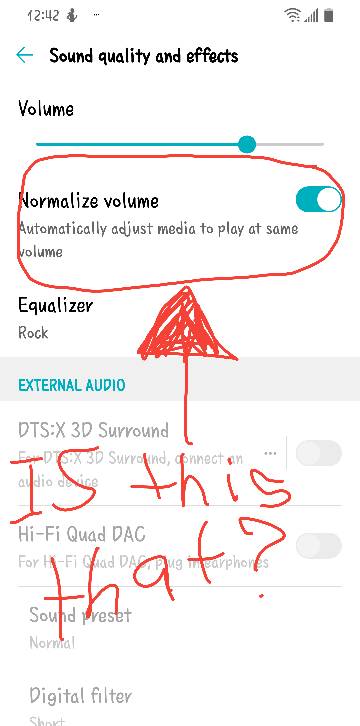

Is this that?
I posted this query over on reddit and curiously some people are saying that sync works for them. I’ve had the G6, V30 and now the G7 and it has not worked on any of them.
