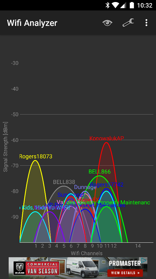

I just confirmed it happened on my mother's phone so maybe it is interference. Here is a scan from yesterday. I'm on ch 1 now and it seems a bit better but still happens.
I'm KonowalukAP
Yeah, it's pretty congested in your area.
