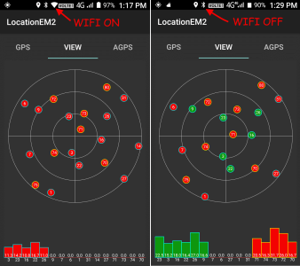

Turning off wifi while using the GPS resolves the problems. It appears to be a software driver issue in Android 6.0. The wifi beacon is degrading the GPS satellite signal. The GPS L2 frequency is 1227.60 MHz, and 802.11b wifi channels 9 and 10 are right in the middle of THE first harmonic of the GPS signal.
