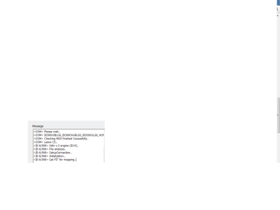

ive done it ! HAHA IT'S WEIRD BECAUSE ODIN WORKED WAS BECAUSE MY DEVICE GOT BRICKED.
Things got worse before they got better
