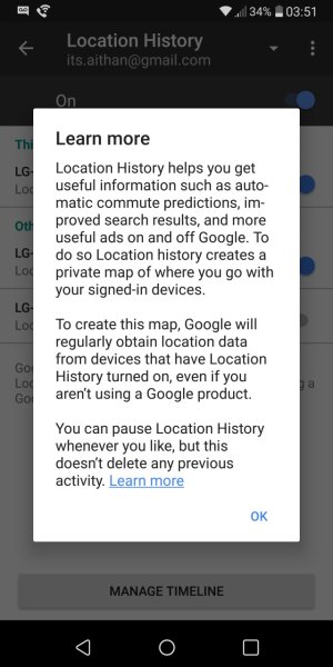

I found Google's own answer, finally.
And yeap, 'helpful' includes ads.
