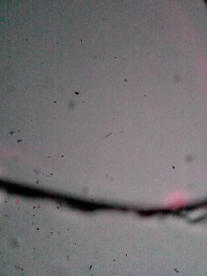

Hi, I have a weird black line and various dots and other marks on any photos taken with my front facing camera. I can't see any cracks when I look at the camera. The marks only just appeared after months of normal appearance. Any ideas what they are and whether the problem will be covered by warranty?2013-10-21 17.45.18.jpg

It looks like indeed like some debris has arrived inside the lens glass. I would at least inquire about a warranty replacement.
If warranty replacement doesn't work out, you can try cleaning the debris yourself, using this video as a guide to opening the Nexus 4 case and accessing the camera module. It doesn't llok to be terribly difficult.
