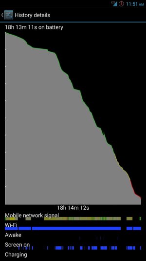

Example battery history graph:

What is the media that's showing up in your battery stats? Download an app called WakeLock detector. Your phone appears to be awake for extended periods of time which is what is causing the unusually faster battery drain. That app should tell you what's causing it to stay awake
Also, I think some of it can be blamed on the poor signal. Haven't been to Mexico recently but I'd imagine the service isn't on par with what you get here

If you look at my screenshots, you'll see details for "media". It appears to be a group of internal Android processes -- beyond that I don't have any more information.
As with being awake, that is a normal amount of awakedness for me. Also, you'll see that despite being frequently awake, the phone is charging and usually the recharging power far outweighs the battery drain from normal use. Furthermore, it wouldn't explain the overnight scenario where my phone is almost never awake.
And concerning the signal strength, the tremendous battery drain occurs even in airplane mode so the signal strength can't be a major contributor to the problem.

By awake I do not mean in use. Notice under the "screen on" bar in the stats there is one for "awake." That bar shouldn't be anywhere near that full, let me post a picture of mine and you'll see that even when the phone is in use, the awake line isn't nearly as full
Notice that I only have a few "blips" in the line for the phone being awake, despite having used the screen for almost 6 hours that day.
