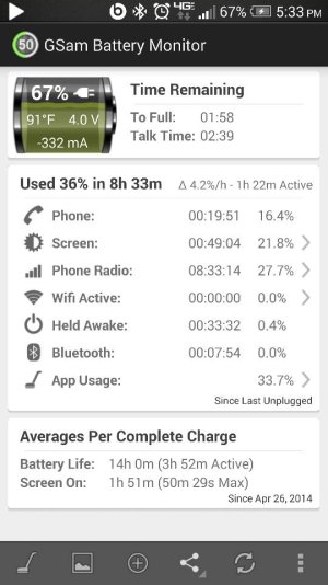

For me, the biggest reason for the battery drain seems to be phone radio. Phone radio has used 60% of my battery and it's just been sitting on my desk all day I haven't even used it.. any way to stop this?
Sent from my HTC6435LVW using AC Forums mobile app
Yeah, mine has too! It gets to 50% withing 6 hours of light activity. I have to carry my charger with me everywhere. I've even tried using the 360 Security app that has a battery booster.
