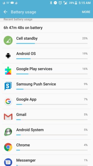

I am seeing some pretty hefty battery drops. I had my phone charged up before I went to bed and I woke up with 29%. Anyone have any ideas why this dropped so much?
Note 5 running Marshmallow on Sprint Network.

Your Cell Standby is fairly high, which suggests poor signal (which can contribute to battery drain).
