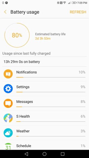

That's terrible. When you look at the battery usage does anything jump out as abnormal?
