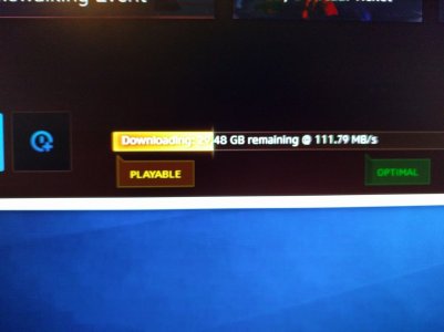

That may be true. Depends what you're doing, Rukbat :). When downloading large games and such I actually DO use the connection I get from my ISP to the fullest (1 Gbps). I get it isn't always but there are times it is used / needed / wanted :). So I def. disagree that a 1 Gbps connection "doesn't help". Ensure to test before you state fact. From a crappy server I could see a slower download since as you said -- it does rely on them / what they deliver. Such as when downloading Battlefield 1 from Origin it only goes around 50-60 MB/sec since the server won't give me anymore ... But there are SOME that do give the speeds so therefore the speeds DO make a difference.
An example is below when downloading WoW (World Of Warcraft) after re-activating. I stayed around 110-120 MB/sec the whole download.
